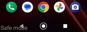

  4. Upon restart, 'Safe mode' appears in the lower-left of the unlock / Home screen.
    Safe mode
