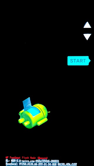

  2. Press and hold the
    Volume Down button
  3. While continuing to hold volume down, press and hold the
    Power button
    (right edge; below Volume button) until the 'Fastboot Flash mode' screen appears (image of an Android with Start).
    Android Recovery start Screen

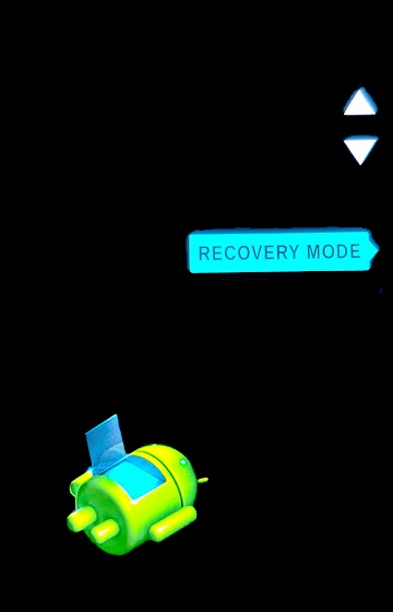

  4. From the Bootloader selection screen, select
    RECOVERY MODE
    Utilize the Volume buttons to cycle through the available options and the Power button to select.
    Android Recovery mode

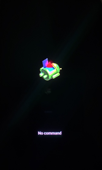

  5. If presented with an image of a broken Android with 'No Command' shown on the screen, press and hold the
    Power button
    , press the
    Volume Up button
    once then release the Power button.
    Android Recovery Screen With No Command

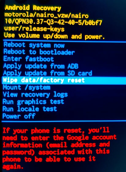

  6. From the Android system recovery screen, select
    Wipe data / factory reset
    Android Recovery wipe data

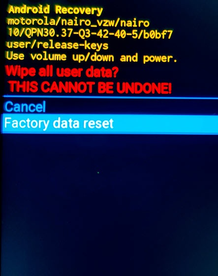

  7. Select
    Factory data reset
    Allow several seconds for the factory data reset to complete.
    Android Recovery user data

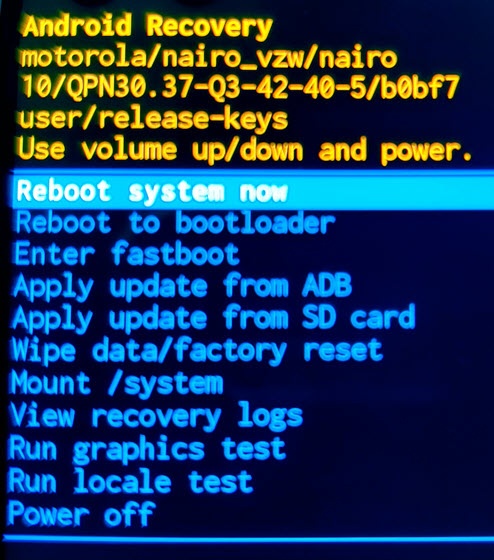

    If applicable, set up your device.
    Android Recovery reboot
