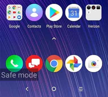

  4. When the device displays Safe Mode in the lower-left, release the
    Volume Down button
    Safe mode
  • With Safe Mode enabled, test device and app functionality. If the previous issue fails to occur, the cause has been isolated to a third-party app and all recently installed or updated apps should be uninstalled.
