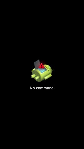

  5. From the Android system recovery screen (image of an Android with an exclamation mark), do the following to display the menu options:
    Ensure the steps below are performed in a timely manner. If power is held too long (longer than 5 seconds), the device resets.
    The image below is an example and may vary by device.
    System Recovery
    1. Press and hold the
      Power button
    2. While continuing to hold the power button, press the
      Volume Up button
      then release both buttons.

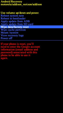

  6. Select
    Wipe data/factory reset
    Wipe data factory reset
  7. Review the 'Wipe all user data' message then select
    Factory data reset
    Allow several seconds for the factory data reset to complete.
