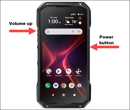

  2. Press and hold the
    Volume up button
    and the
    Power button
    then release the Power button when the Kyocera logo appears on the screen.
    Volume up and power button

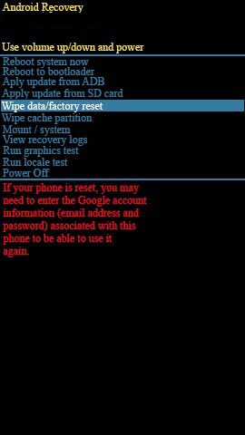

  4. From the Bootloader selection screen, select
    Wipe data/factory reset
    Utilize the Volume buttons to cycle through the available options and the Power button to select.
    The below image is an example.

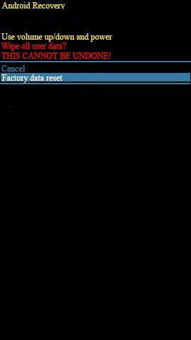

  5. From the Android Recovery screen, select
    Factory data reset
    Wipe user data

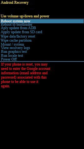

  6. Select
    Reboot system now
    Allow several minutes for the reboot process to complete.
    If needed, set up your device.
    Reboot System Now screen
