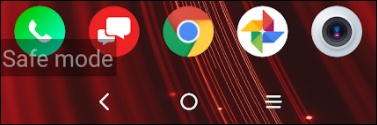

  3. From the 'Restart in safe mode' prompt, tap
    TURN ON SAFE MODE
    This process may take up to 30 seconds to complete.
    Upon reboot, 'Safe mode' appears in the lower left of the screen.
    Home screen with Safe Mode active
