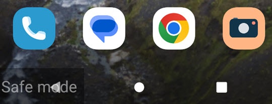

  2. Touch and hold 'Power off' until 'Reboot to safe mode' screen appears.
  3. From the 'Reboot to safe mode' prompt, tap
    OK
    to confirm.
    This process may take up to 60 seconds to complete.
    Upon reboot, 'Safe mode' appears in the lower-left of the screen.
    safe mode screen
