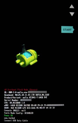

  3. While continuing to hold volume down, press and hold the
    Power button
    until the 'Fastboot Flash mode' screen appears (image of an Android with Start).
    The image below is an example.
    Android Recovery start Screen

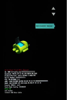

  4. From the Bootloader selection screen, select
    RECOVERY MODE
    Utilize the Volume buttons to cycle through the available options and the Power button to select.
    Android Recovery mode

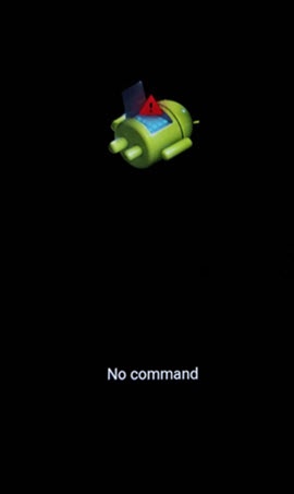

  5. If presented with an image of a broken Android with 'No Command' shown on the screen, press and hold the
    Power button
    , press the
    Volume Up button
    once then release the
    Power button
    Android Recovery Screen With No Command

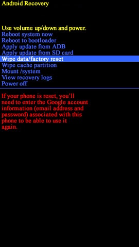

  6. From the Android system recovery screen, select
    Wipe data / factory reset
    Android Recovery wipe data

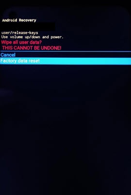

  7. Select
    Factory data reset
    Android Recovery can't be undone

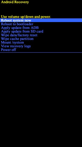

  8. Select
    Reboot system now
    Allow several minutes for the reboot process to complete.
    If applicable, set up your device.
    Android Recovery reboot
