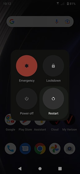

  1. With your device powered on, press and hold the
    Power button
    until the 'Power off' prompt appears on the screen then release.
    Power button
  2. Touch and hold
    Restart
    until the 'Reboot to safe mode' prompt appears then release.
    Tap and hold Restart

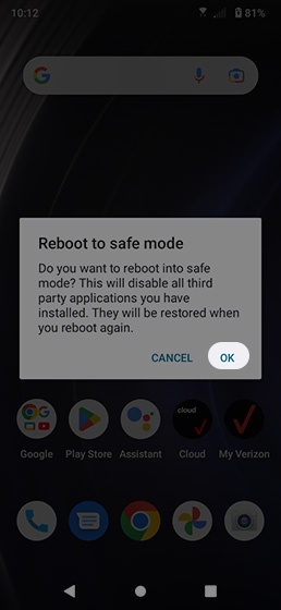

  3. Tap
    OK
    to confirm.
    Reboot to safe mode
