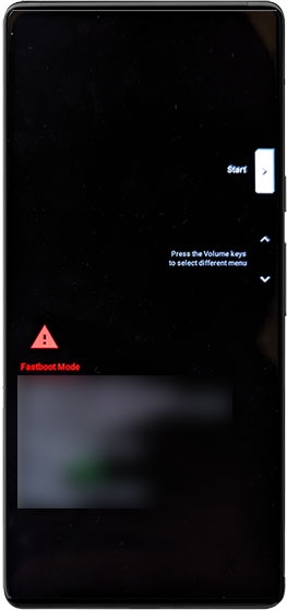

  2. Press and hold the
    Power and Volume Down buttons
    until Fastboot mode (image of a triangle with an exclamation point) appears, then release.

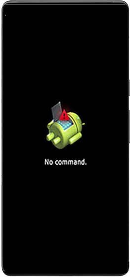

  3. If presented with an image of a broken Android with 'No command' shown on the screen, do the following:
    1. Press and hold the
      Power button
    2. While holding the
      Power button
      press the
      Volume Up button
      then release both buttons.
    Android Recovery Screen With No Command

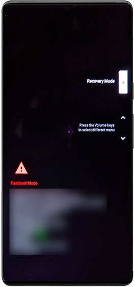

  4. Select
    Recovery mode
    Use the Volume buttons to cycle through the available options and the Power button to select.
    The device flashes the Google start screen momentarily and then restarts in Recovery mode.
    Android Recovery Screen With Recovery Mode

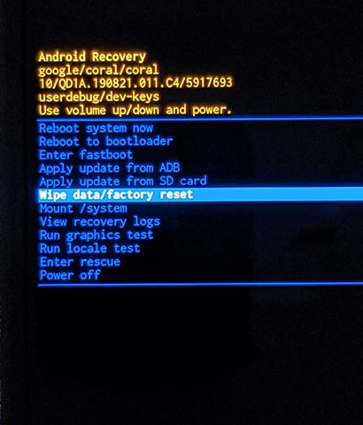

  5. From the Android Recovery screen, select
    Wipe data/factory reset
    Android Recovery Screen Wipe Data

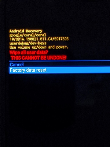

  6. Select
    Factory data reset
    Allow several minutes for the factory data reset process to complete.
    Android Recovery Screen Select FDR

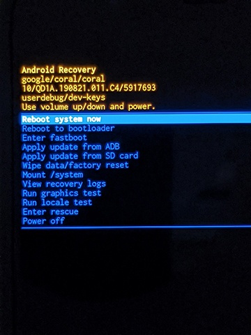

  7. Select
    Reboot system now
    Allow several minutes for the factory data reset and reboot processes to complete.
    If applicable, set up your device.
    Android Recovery Screen Reboot System
