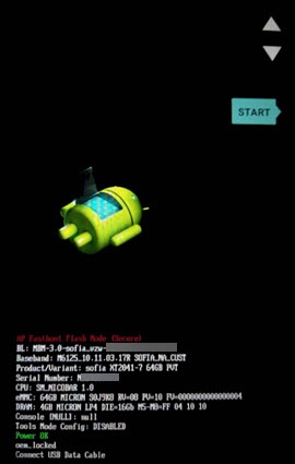

  2. Press and hold the
    Volume Down button
    Volume down power button
  3. While continuing to hold volume down, press and hold the
    Power button
    until the 'Fastboot Flash mode' screen appears (image of an Android with Start).
    The image below is an example.
    Android Recovery start Screen

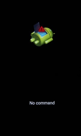

  5. If presented with an image of a broken Android with 'No Command' shown on the screen, press and hold the
    Power button
    then press the
    Volume Up button
    once then release the
    Power button
    Android Recovery Screen With No Command

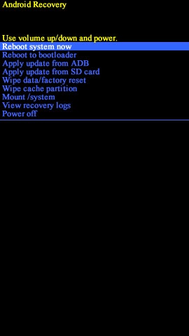

  6. From the Android system recovery screen, select
    Wipe data / factory reset
    Android Recovery wipe data

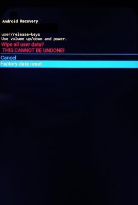

  7. Select
    Factory data reset
    Android Recovery can't be undone
