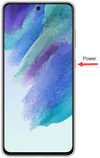

  1. With the device powered off, press and hold the
    Power button
    until the device vibrates and the 'Samsung' screen appears then release.
    Power button

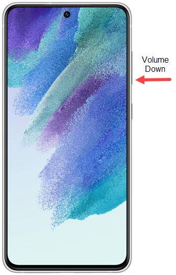

  2. When 'Samsung' screen appears, press and hold the
    Volume down button
    Volume down button
  3. Continue to hold the
    Volume down button

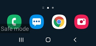

    until 'Safe mode' appears in the lower-left of the unlock or Home screen then release.
    This may take up to 45 seconds.
    Safe mode screen
