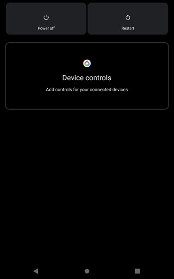

Preferred Method
  1. Press and hold the
    Power button
    until the 'power options' menu appears.
    If the device is unresponsive, attempt the alternate method.
    Power button
  2. Tap
    Restart
    If your device won't power back on, partially charge the device then retry.
    Power button options
