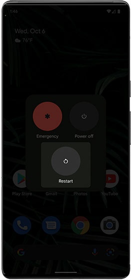

  2. Touch and hold
    Restart
    until the 'Reboot to safe mode' prompt appears then release.
    Tap and hold Restart

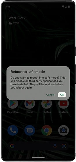

  3. Tap
    OK
    to confirm.
    Reboot to safe mode
    The restart process may take up to 45 seconds to complete.

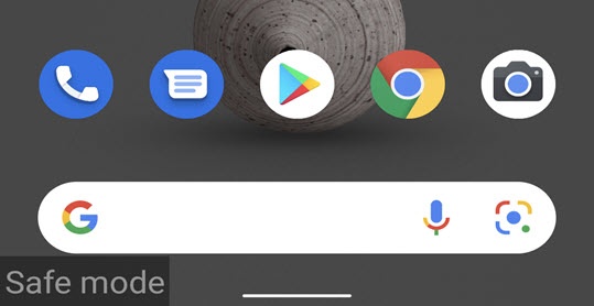

    Safe mode enabled
    Upon restart, 'Safe mode' appears in the lower-left of the unlock / Home screen.
  4. With Safe Mode enabled, ensure Airplane Mode is turned off then test device and app functionality.
    To exit Safe mode, restart your device.
