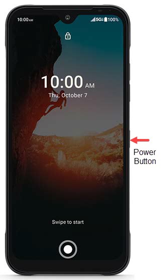

  1. Press and hold the
    Power button
    (right edge) until the 'Power off' option appears on the screen then release.
    Power button

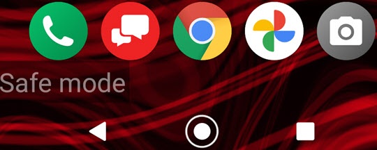

    Upon reboot, 'Safe mode' appears in the lower-left of the unlock / Home screen.
    Safe mode screen
