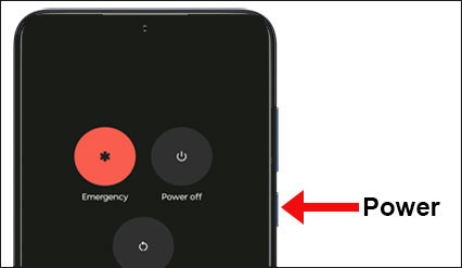

Preferred Method
  1. Press and hold the
    Power button
    (on the right edge) until the power menu appears then release.
    If the device is unresponsive, attempt the alternate method.
    Power button menu
  2. Tap
    Restart
    If your device won't power back on, partially charge the device then retry.
