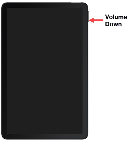

  3. Approximately 2-3 seconds after the TCL logo appears, press and hold the
    Volume Down
    button.
    If pressed too soon, the device won't boot into Safe Mode.
    Volume Down button

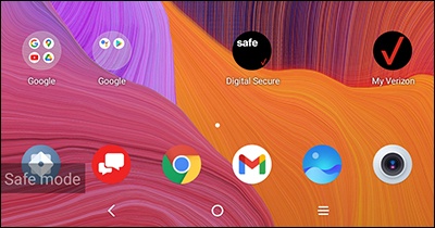

  4. Continue to hold the
    Volume Down button
    until 'Safe mode' appears in the lower-left of the screen then release.
    This may take up to 45 seconds.
    Safe Mode screen
  5. With Safe Mode enabled, test device and app functionality.
