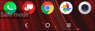

  3. Continue to hold the
    Volume down button
    until 'Safe mode' appears in the lower-left of the screen then release.
    This may take up to 45 seconds.
    Safe mode indicator
