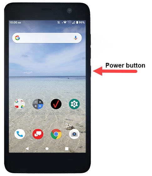

  1. With the device powered on, press and hold the
    Power button
    until the 'Power off' prompt appears on the screen then release.
    Power button

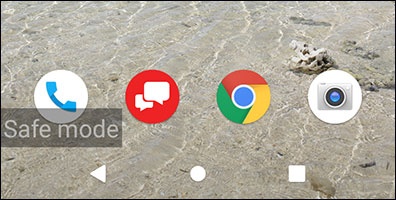

    The restart process may take up to 45 seconds to complete.
    Upon restart, 'Safe mode' appears in the lower-left of the unlock / Home screen.
    Safe mode enabled
  4. With Safe Mode enabled, ensure Airplane Mode is turned off then test device and app functionality.
    To exit Safe mode, restart your device.
