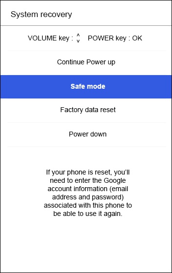

  3. Select
    Safe mode
    Utilize the Volume buttons to highlight the option and the Power button to select.
    Recovery Mode screen with Safe mode selected
