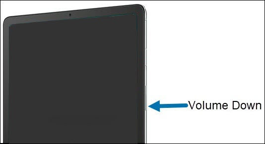

  1. With the device powered off, press and hold the
    Power
    and
    Volume down buttons
    until the Samsung Galaxy Tab A screen appears.
    Power Volume Down Buttons
  2. Release the
    Power button
    but continue to hold the
    Volume down button
    Volume down button

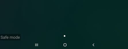

  3. Continue to hold the
    Volume down button
    until 'Safe mode' appears in the lower-left of the unlock or Home screen then release.
    This may take up to 45 seconds.
    Safe Mode
