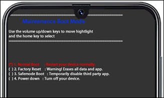

Alternate Method
  1. Simultaneously press and hold the
    Power
    Volume Down buttons
    (right edge) until the screen goes dark then release both buttons.
    Allow up to 15 seconds for the Boot Mode screen to appear.
    Power and Volume down buttons
  2. From the 'Maintenance Boot Mode' screen, select
    Normal Boot
    Utilize the volume buttons to cycle through the available options and the power button to select.
    Allow several seconds for the device to restart.
    Boot Mode
