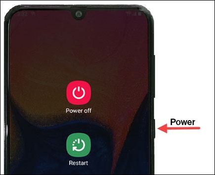

Preferred Method
  1. Press and hold the
    Power button
    (right edge) until the 'Power off' prompt appears then release.
    If the device is unresponsive, attempt the alternate method.
    Power button
  2. Tap
    Restart
  3. To confirm, tap
    Restart
    Allow up to 30 seconds for the reset to complete.

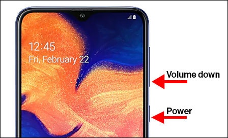

Alternate Method
  1. Simultaneously press and hold the
    Power + Volume down buttons
    (right edge) until the screen goes dark then release both buttons.

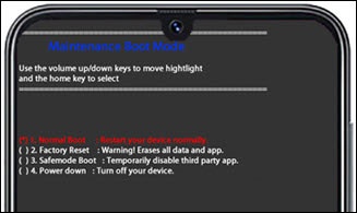

    Allow up to 15 seconds for the 'Maintenance Boot Mode' screen to appear.
    Power and Volume down buttons
  2. From the 'Maintenance Boot Mode' screen, select
    Normal Boot
    Utilize the Volume buttons to cycle through the available options and the Power button to select.
    Allow several seconds for the device to restart.
    Boot Mode
