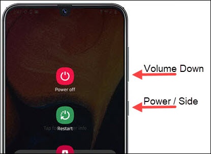

Preferred Method
  1. Press and hold the
    Power / Side
    and
    Volume down button
    (right edge) until the 'Power off' prompt appears then release.
    If the device is unresponsive, attempt the alternate method.
    Power off menu
  2. Tap
    Restart
  3. To confirm, tap
    Restart
    If your device won't power back on, partially charge the device then retry.

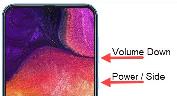

Alternate Method
  1. Simultaneously press and hold the
    Power / Side
    and
    Volume down buttons
    (right edge) until the screen goes dark then release both buttons.
    Allow up to 15 seconds for the Boot Mode screen to appear.
    Power and Volume down buttons

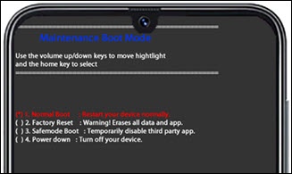

  2. From the 'Maintenance Boot Mode' screen, select
    Normal Boot
    Utilize the volume buttons to cycle through the available options and the power button to select.
    Boot Mode
