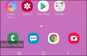

  3. Continue to hold the
    Volume down button
    until 'Safe mode' appears in the lower-left of the unlock or Home screen then release.
    This may take up to 45 seconds.
    Safe mode screen
  4. With Safe Mode enabled, ensure Airplane Mode is turned off then test device and app functionality.
  5. To exit Safe Mode, restart the device.
