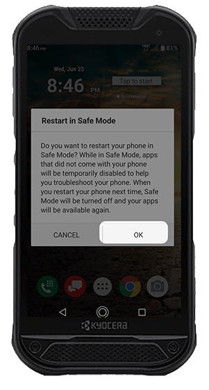

  2. Touch and hold
    Power off
    until the 'Restart in safe mode' prompt appears then release.
    Power off
  3. From the 'Restart in Safe Mode' prompt, tap
    OK
    to confirm.
    Allow approximately 1 minute for the process to complete.
    Safe mode
  4. Upon restart, 'Safe mode' appears in the lower-left of the unlock / Home screen.
