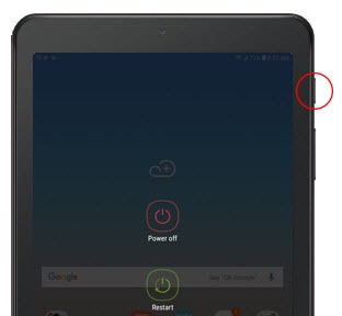

  1. Press and hold the
    Power button
    until the 'Power off' prompt appears on the screen then release.
    Power button
  2. Touch and hold
    Power off
    until the 'Safe mode' prompt appears then release.
  3. Tap
    Safe mode
    to confirm.
    This process may take up to 45 seconds to complete.
    Upon reboot, 'Safe mode' appears in the lower-left of the unlock/home screen.
  4. With Safe Mode enabled, test device and app functionality.
