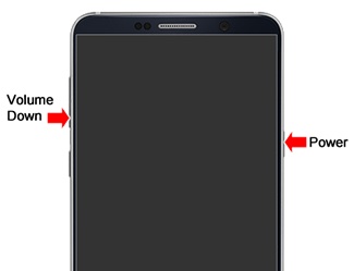

Alternate Method
  1. Simultaneously press and hold the
    Volume Down button
    (left edge) and the
    Power button
    (right edge) until the 'Maintenance Boot Mode' screen appears then release.
    Power and Volume down buttons

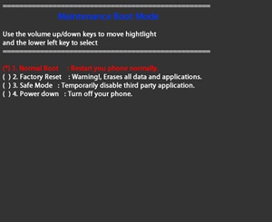

  2. From the 'Maintenance Boot Mode' screen, select
    Normal Boot
    Utilize the volume buttons to cycle through the available options and the lower left button (on the left edge; below the volume buttons) to select.
    If your device won't power back on, partially charge the device then retry.
    Maintenance Boot Mode with Normal Boot
