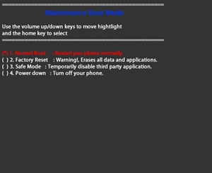

  2. From the 'Maintenance Boot Mode' screen, select
    Normal Boot
    Utilize the volume buttons to cycle through the available options and the Home button (below the display) to select.
    Maintenance Boot Mode with Normal Boot
  3. Allow several seconds for the reboot process to complete.
